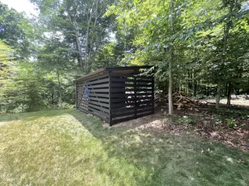

I'd cross stack the edges of your stacks to avoid them leaning too much on the boards.
Also, screws are less strong than nails. (Hence no screws in e.g. framing of homes.)

Do you think I should go back through and add some nails to each board? Or will three two inch screws per post, so 9 screws per board be enough?

Depends on how far the boards will bend; screws do fair when being pulled straight, but poorly when shear forces are present. If the boards bow out a lot, more shear forces appear.
I'd add a 3" nail every where you have screws there to take the shear forces
Maybe the boards would crack first then...

I can take a measuring tape out and take pictures if anyone needs proof 😄😁This weekend we moved about 5-5.5 cords in the right hand side, it is 10 feet deep, 10 feet wide, and 7-7.5 feet tall of firewood densely packed.
I have to admit, I never would have thought this would fit ten cords either, but its incredible how many cords fit into a dense cube.

Sorry I'm late to the thread but I built one that is very similar and the only thing I thought of right away was the sides have no bracing. In the rear you put in those diagonals, the sides would benefit from them too.
Then you could have painted the shed before filling it. I like stain or paint to protect the wood and keep it looking nice.
I do like how you added posts to the center of the three short walls. I spanned the 10 feet with 2x6 horizontals and I think intermediate posts would be a help.
Mine is the same shape too and to avoid side forces from the wood to the walls I stack a row down all four sides. then fill in the middle with 6 rows. All four corners get a cribbed stack. Wood shrinks a lot as it dries, you'll be able to see that now.
On edit, screws are very strong. No need to fret. Just like nails, you can buy strong screws or weak screws. To really worry or be critical of the screw choice you would need to know the specific screws and nails to compare. I used a lot of screws too. The reason they frame houses with nails is cost. Labor and materials cost is lower when spitting nails from a nail gun.

Today we got the rest of the firewood moved into the shed, moved about a half cord onto the covered front porch too. Feels great to have all the wood under a roof! Also went through and added three inch nails to all the side cladding to strengthen it just in case in addition to the screws.

Why did you sink the posts in concrete instead of using steel anchor plates? Your method seems more cost effective.
Was it hard to plumb the long heavy posts?

No reason for the concrete other than that's what I was familiar with! It wasn't too difficult to plumb them, we laid out the grid with string and extra stakes (copied what we saw them doing when they built our pole barn) and were able to get it fairly square keeping the posts flush against the string. Then as we filled in the concrete dirt just kept checking the level. I am sure its not "perfect", but its so close you wouldn't notice and came out pretty square when we put the roof on.

Very nice looking shed. I have similar, but 8x8 bays. Made 3 then added a 4th. I loosely stack enough wood for one season in 2, then have the other 2 for the following year. Always stay ahead 2 years that way. Wood dries pretty good but you have to stack it loose, lots of air gaps.

I notice with my shed I will stack right to the very top and 2 years later when I'm ready to burn it, everything has settled / shrunk a good 5-10" lower then the main beam on top

Yes, same here. For the pine that I stacked last summer, I already gained about 3". (Pine going faster than the oak, of course, and possibly shrinking more in total too.)

A little air space in the stacks helps with drying in my shed but I don’t leave any space between the rows and can absolutely state for fact that it does not hinder the seasoning in the center of the shed.
I do the same thing. I'm not spending all that time, money and time to build an air shed. I want it to store firewood. I fill it to the brim. When I need it, it will be dry.
Caveat: Any wood I put up, I don't need for at least five years. :)
