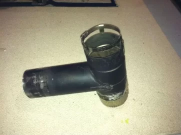

This is the single wall T originally installed on my Lopi. I don't know what brand it is. I changed it out for ICC. The cleanout cap is not on it. The horizontal end was stuck into stove outlet collar. There was no stove adapter.
Is that stainless???

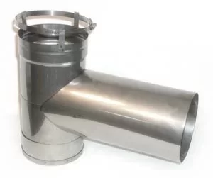

looks like a tee for a liner setup.
Was that on an insert?
http://www.chimneylinerdepot.com/store/519/product/Complete-Flex-Liner-Tee-3".html

Yes it's stainless painted black. It went onto a flex liner secured with hose clamp & Rutland tape.
