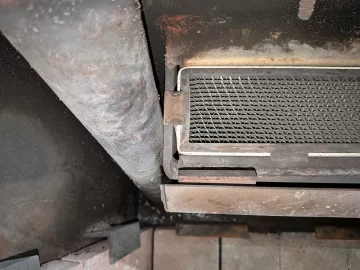

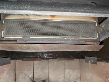

I was performing some pre-season checks on my Sirocco 25 insert that was installed last year, and noticed the combustor gasket was shot, whether it was that way from the installation last year or the chimney sweep this year I'm not sure. Either way, I pulled the combustor out, gently cleaned it with a vacuum, and reinstalled the gasket per the manual instructions. When I slid the combustor back in, I notice a slight gap on one side. The manual states that the gasket will swell to provide a tight seal, but I'm now wondering if my combustor housing is missing retaining clips. I watched a few Blaze King videos and noticed that some other stoves have these clips (6:12 in this video )
Could anyone with a Sirocco 25 check to see if they have these clips on the side of their combustor?
