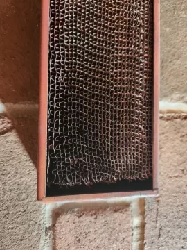

New member here with a question for the experts! Picked up a new gasket this morning and went to install it. I noticed this gap between the combustor and the metal frame/housing. This can't be normal I imagine? It's only two years old, am I looking at needing a new combustor?

Contact your dealer for warranty coverage. It appears the brazing did not hold.

Picked up the new combustor this morning and brought the old one to the dealer to ship back. Has a note to have you take a look at it. From the photo, is it something you have seen before? Anything I may have done wrong to cause it?
