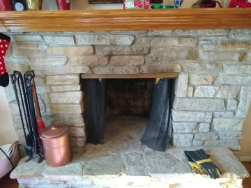

So after delays of trains across the country and inclement weather during the install date yesterday tomorrow it should go in prior to an evening where we're expecting 10"+ of snow. Look forward to learning here. Have wood inside to not steam and damage my cat right off the bat. So here is the before shot. Look forward to the install shot tomorrow.

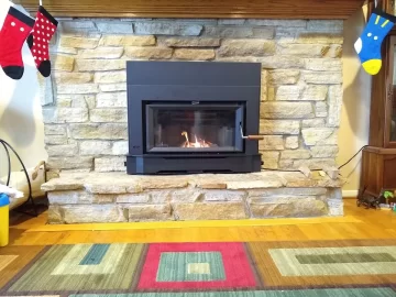

Install finally done at long last. Looking forward to years of joy from this insert.
Have to figure out how to get the shroud to rock gap really covered. Rock wool for now but from the side doesn't look great. Possibly metal strips. We'll see. For now happy with the heat. Here is the first fire and straight on shot.

moresnow
Jan 13, 2015
1,793
Iowa
Looks great.
Perhaps gaps at the stone just let out more passive heat anyway...... Worth experimenting.

Liner insulated. Top cap, rock wool at top of old smoke box packed in. They'll come back out for the block off plate after getting those measurements today since I requested that added after reading your stuff from before and others recommending it as well. Definitely a powerful curing smell, but got windows open and will keep a small fire burning for a few days to get it all the way cured/broken in.
Thank you all for all the help getting here. Only question I have for now is, what the hell took me so long to get one of these?
@BKVP tell those back at the shop thank you for this. Kids already found their favorite spot right in front here.
Will be reporting back to all on updated burns etc and will definitely be reviewing after I get a better understanding of everything

Now the install is done it is easy to detach the liner connector to the stove, just 4 bolts and its off, but you might need to get a new gasket. Run it for a bit and see how it heats, if you feel you are loosing heat to the fireplace I would recommend pulling the insert and insulating the inside of the fireplace to keep the heat IN the fireplace hole, not escape to the outside world.
Cement board found at the big box stores works good, and if you can fit roxul behind it, even better:

Yup. Will run it through the winter. And if needed will do that adjustment in the spring. Already pretty impressed with the burn times etc. 12 hours on medium with oak splits not jam packed with plenty of coals in the morning to light it back up.
Woke up had a cup of coffee in front of last night's load before even bothering on the reload. Figured it's probably better to be caffeinated before I start reaching in with logs.
