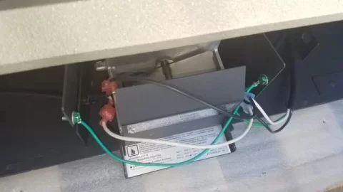

I had a Sirocco 25 insert installed in my fireplace. Blaze King apparently does not include a serial number card with the stove; instead they rely on the installer to fill out the information on the manual. I suspect the serial number is on the side or the back of the insert somewhere where it's completely inaccessible to me. I have to say, it seems quite silly to rely on a contractor to fill out a form when they are focused on the physical task of installation and generally not the type of person to make notes.
Needless to say, my installer did not write down the serial number or take a photo of it. So how do I complete the warranty form? Why can't Blaze King include the serial number on a card, or put the serial number somewhere visible after installation?

If no one here knows it, ask @BKVP for the location of the serial.

Thanks. Anyone know if the serial is on the side? If it's on the back I wouldn't even be able to see it after removing the shroud, so I wouldn't bother.
Open the front bottom cover and below the tstat a card pulls out with all the info.

On second thought you might not have to pull the front cover to get to that, might just be able to pull it out with the cover on.
Ah, thank you! This is smart. I don't see any mention of it in the manual, which is not so smart.
