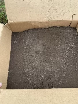

I just got done sweeping my flue. I have burned more pine this year than the last two. Couple observation. It burns sootier than hard wood and because of the pitch you can burn it wetter than hard wood. What I saw was a bunch of brown light fluffy soot. No creosote at all. The pine also make a filament like carbon ash that was accumulating on my cap. Take some binoculars or a drone and look up at your caps. this is what my sweepings looked like. Nothing to worry about but it was time to clean it.
Evan
