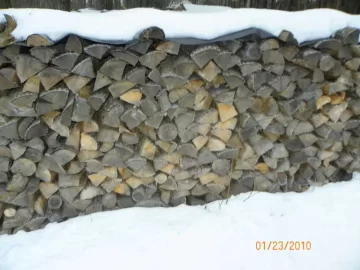

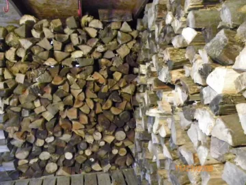

If you look at several wood stacks, in particular those of zap's, Dexter Day's, BogyDave's and many many more you will see some really nice tight stacking of the wood. Then you'll see some others where it just takes a glance to see how loosely the wood is stacked and occasionally a stack or two might look sloppy. Each type of wood stack has good points. I've been accused wrongly of stacking neat and tight but that is false.
If you look at these 2 pictures (click on them to see regular size rather than thumbnail pictures) you will see some loose wood stacks. For example, in the first picture if you look closely you will see right through the stack. Then look at the gaps or holes in the second wood stack. This is an example of stacking loose rather than tight. It could also be stacked with larger air holes. In addition, most of this wood is not split into large splits but most are what we call small or medium.
