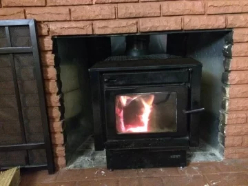

This is what I did.
[Hearth.com] Small wood insert with cooktop?
