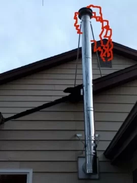

Your point I have clipped above is interesting - first time I recall reading/you mentioning that the smell is more away from the stove and more in other rooms. I went back and skimmed the whole thread - noticed your original pics. Is there any possibility smoke may be entering the attic space, then get drawn back into the living space, making a smoke smell stronger in other rooms of the house?
  • [Hearth.com] Smell won't go away on new stove
Interesting observation. Depending on the prevailing wind direction it might be contributing. Closing off that vent as a test is one way to tell.
Been following and periodically replying to this thread over the months. Nice to see you're making progress and I really hope the new stove fixes the problem for you! IMHO, normal operation a stove should not really smell at all. You might get a whiff of wood smoke from opening the door, the 'first time of the year' smell, or a bit of a hot smell if you really crank the temp up - but normal operation, it should not smell any more than a gas furnace, which should also have no smell. I've had a few guests come into the front rooms of my house and spend time, then they walk into the family room and are surprised to see a fire going. Maybe they just aren't attentive, but if the 'ol box made much smell, I'd think they would know it.
Good thought, but no, that isn't the issue. I like the drawing though :-) I know it's not the issue since you can smell the smell coming right off of the stove as it is burning. It smells pretty strongly right above the stove. It does seem to "settle" in the cooler areas of the house. The stove dealer said it's the same smell he got when curing a new stove at their shop. And he noticed that when he walked in the front door (not near the stove), that's where it smelled the strongest.
