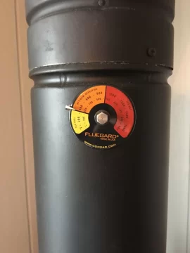

Do you have a pipe thermometer installed. Just shooting from hip here is the pipe hitting new temps and maybe the paint from that. Seems like you shouldn't have a issue a month in
No, it's a double walled stovepipe. It seems the ones I've seen are for single pipe and thus wouldn't be accurate?? They did spraypaint the stovepipe at the end of install. Although I think I smell the smell coming from the stove itself (I put my face a foot or so above the stove last night and smelled it pretty strong). Thing is, it smells (although to a lesser extent) everytime it hits 550-600.

I looked at manual online and I didn't see wht temp they considered over fire for your stove. Unless I overlooked it. But condor fluegard is a good one for double wall that's what I have. It's probe type. Drill a hole on and it's held secure by magnet [Hearth.com] Smell won't go away on new stove
