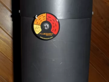

I looked at manual online and I didn't see wht temp they considered over fire for your stove. Unless I overlooked it. But condor fluegard is a good one for double wall that's what I have. It's probe type. Drill a hole on and it's held secure by magnet View attachment 192697
I am also using a Condar FLUEGARD with probe for double wall pipe, it is the best I have used out of three purchased specifically for double wall pipe.

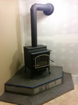

Here's the inside:

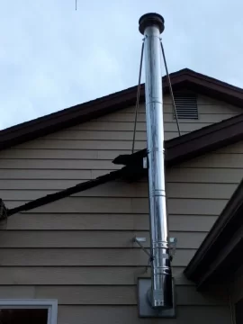

The horizontal part going into the wall goes directly to this outside:

I'm going to say that you are smelling smoke due to poor draft. You have some stuff working against you here.
Basement installs often struggle, Tee systems also struggle because you have 2 90 degree turns. Outside you've got several rooflines to contend with, that can cause strange wind directions, pressure differences and downdrafts. To sum it up: basement install, tee system, short chimney. These all are working against you here.

Add pipe. Real easy and it won't hurt in my opinion. With the 2X 90 deg. bends, horizontal run, elevated nearby roofline. I would try more pipe .Reasonably inexpensive possible cure.
