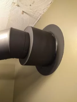

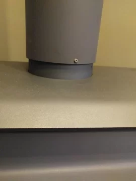

Doesn't look like any at the flue collar. There was a caulking used where the flue goes into the wall. I do know the caulk there does smell, but I don't think that's the issue. That area doesn't get very hot (maybe 100F). They used it on the outside as well. You can smell it if you put your nose right to it.

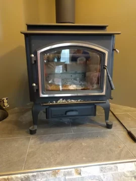

Maybe something will show up if you can post a picture of the installation starting with the stove, then the flue collar, then the connection at the thimble where it goes through the wall

Well from pictures only thing I can see is the is the caulking at the wall but smelling outside is kind of ruling that out. The pipe seems to be graying pretty quick. I've only used supervent. Maybe that's another brand and that's normal for the brand. How much paint did they use and did they put any paint on exterior chimney. Normally paint curing smell goes away after you hit that temperature. So say you hit 500 then it went away then when you hit 600 you might get a faint smell again. What's the set up look like from outside?

Looks like silicone was used at the outside edge of the wall thimble but that should stay cool enough to not be an issue unless the product was defective.

OP could I bother you for a pic showing the stove and the whole connecting pipe?
