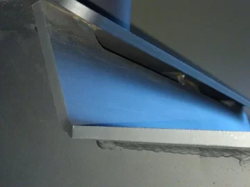

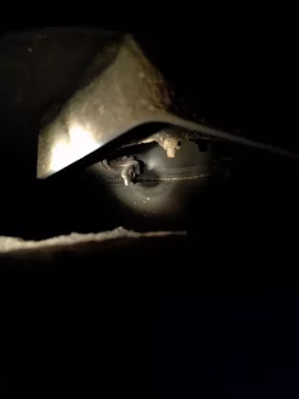

So, I took off the back cover to look into the chamber at the top of the stove. There are two air vents that you can feel air coming out of (while it's burning) on the front of the stove at the "step." I think this is normal and it's supposed to pull air up and out in this way. Anyways, that location seems to be where I get the strongest smell.

I was hoping I would take it off and see some melted toy some kid stuck in there while it was on the floor of the store for two years. Unfortunately, it wasn't that easy. I have a few questions though.
1. Biggest question: Is there supposed to be a weld where the pipe (I'm sorry, don't know the correct terms for these parts) comes through the thick steel? There are welds everywhere else, but it seems odd that there wouldn't be one there.

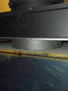

Here's a view from the inside top. As you can see, no weld on top or bottom.

2. The welds that are not painted have a pretty rusted color to them. Is this normal for non-painted areas?

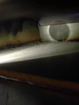

3. On the top, there are hundreds of little beads. It looks to me like leftovers from the welding. I'm assuming there's no issue here, but figured I'd ask. You may need to click on thumbnail to see it bigger.

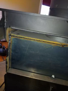

Was this stove repaired at some point? It seems a little odd that nothing is painted back there. I would not expect to see the raw welds and smoke marks, but I haven't taken the back off of a Quad and maybe that's how they ship them now.

Somebody is lying...that stove has been repaired. I studied metallurgy for a few years and welded professionally for a number more in a manufacturing environment. That welding job was done after the fact. They did not completely clean the original fillet weld out to my eye and rolled the new weld...the dots are welding splatter..that in its self is not a issue but once again it points to being welded after the fact as everything is usually media blasted for final prep prior to painting..I don't like the smell of this...pun intended.

I agree. I'm no welder, but I have my hands on new stoves everyday. I've never seen welder smoke marks on a stove, some splatter on occasion, but typically in areas there's no way you could snap a pic..

It is possible that this was done before it left the factory after failing inspection...BUT it is awfully sloppy work and should never have left before being cleaned up. As you noted a small amount of welding splatter can be present as it is sometimes impossible to clean it all up...there was no attempt here..I don't like it...

I've seen used stoves be returned to the factory for repair that came back in better condition than that.

I absolutely would bring it up..I think its a bad weld with porosity(void fraction) in it which in turn is allowing a small amount of smoke to escape upon exspansion.I have seen many items rewelded after failing inspection standards. It is very common practice to save the product.

If that is the actual pipe carrying flue gas/smoke out of the stove, then YES, it should ABSOLUTELY be welded to the top of the firebox.

I can not imagine ANY reason there would NOT be a weld at the pipe joint you mention. That is the actual flue pipe connected to the firebox at the top the stove, correct? ...not some shield or cover or the flue pipe-to-outer-shell joint?

Regarding the welds you found, that yellow-white powder is typically a sign of stick welding or flux core wire welding. The 'hundreds of little weld beads' is also somewhat indicative of stick welding - you get a lot of weld spatter. Though it also suggests the weld parameters were off - likely the weld was too hot causing the spatter instead of the metal laying down in a nice pool.
Either way, it seems a bit fishy to me. Any modern production line is geared for speed and efficiency. Stick welding, flux core and a bunch of weld spatter would not typically be in line with speed/efficiency. I suspect at a minimum they would be doing MIG welds and if I had to do it, I would do spray-arc MIG to boost the welding / metal deposition rates even more - that would leave a very clean weld, no spatter and no 'dust'.

It appeared to me that it is flux-core...a technique reserved for outdoor windy/conditions...this doesn't add up to me.
Why do you say that?
I can see that it's stick welded, but what are you looking at that says 'flux core' to you?
(I am learning welding basics, sorry for the slightly off topic question. :). )
