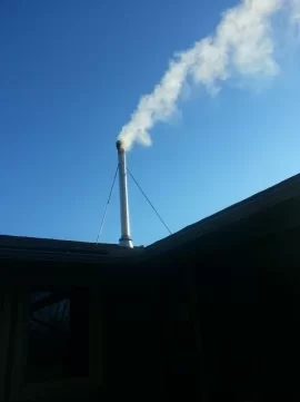

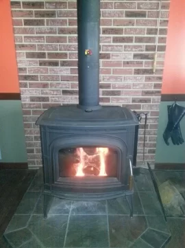

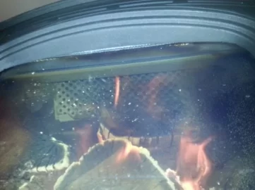

All season there was absolutely nothing coming out of the chimney of my Ashford when the cat was engaged.
Now just before it is about to rocket up in temperature I find that there is smoke bilging from the chimney even after I engage the cat.
I am unsure if my catalyst is not functioning properly or if I am seeing different effects because it is now above freezing.
The thermostat must be set higher and higher to keep the cat probe thermometer from going inactive. Much higher than the setting I was using for long burns earlier in the season.
In these photos the stove has been on the maximum thermostat setting for about 30 min after the cat became active.

Warmer temps may require a higher primary air setting, to compensate for the weaker draft. It seems to be pretty common to have smoke like that when burning with the thermostat wide open. The smoke is moving thru the cat too quickly. I think BKVP called it 'residence time'.
I find that getting the stove and the whole load good and hot, and then closing the air down over an hour or so, lets me burn with the thermostat closed all the way. At some point during the cycle, I need more heat than that, so I open it up for an hour or two. That seems to bring life back into everything, and I can smolder it for the rest of the cycle. This requires really dry wood, or else it just goes out. Most of what I am burning is 15-17%.
Good to know. I recently tried our stove out at 50F and was pleased to see that after 10 minutes there was secondary light off and no chimney smoke. This too requires nicely dried wood.
Every situation is different, but I find the BK takes a little more fussing with in the shoulder seasons. On the other hand, I only have to mess with it every day or two. I also find it easier to reload on a big, though relatively cool, coal bed. It gets charred and back up to active temp faster, and I can cut it back to a low setting sooner.

I think I started worrying a little too soon on this one. I turned the air up and now there is again nothing coming from my chimney.

I randomly see some smoke coming from the cap. Mostly within the first hour of a cold start-up and again 16 hours later or so if I'm trying to stretch out a long low burn. I just kick the T-stat up for a few minutes to allow the cat to get active again.
Something else to keep in mind is that when the cat is new its way more active. It fires up much faster and often gets too hot for a few fires. After a few months of use, they calm down.
This sounds like what you are experiencing to me.
Also do you have the blowers on the Ashford? The blowers will mess with the cat probe thermometer. The blower makes it read much lower than it actually is.
