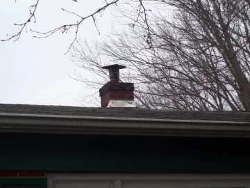

I have a wonderluxe woodstove. I have run it all winter with no problems. It is located in the basement and I have a flex chimneh pipe going up the tile chimney with 2 90 deg bends. I have it approx. 2-3 ft above the roof line with a chimney cap. I noticed a few days ago that some smoke was backing out the door when I would restoke the fire. So I thought I had a creosote build up and inspected my chimney and found the rain cap completely filled in with creosote and some buildup down my chimney. I wire brushed it and cleaned the rain cap. Now I light the fire it burns good. I have all my damper inlets open just as before on initial burn, when I open the door to feed more wood, the fire is almost diminished and smoke pours out into my room. If I leave the door open the fire burns better but some smoke still comes out the door. I have tried leaving a window at the top of the stairs open but that doesn't seem to make a difference. I also got some real seasoned dry wood that I knew was at that did not make a difference. Whats up?

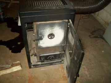

Clogged screen, creosote in the elbows suggests the fire is not burning hot enough, To not have problems in the beginning of the season then to have issue's later means the draft is impeded, OP stated that he cleaned the pipe and screen, which improved burning up until he opens the door to reload. When he opens the door to load what ever little heat that was created is lost up the flu and the fire snuffs it self out to a smoldering mess. This looks like a fuel issue to me.

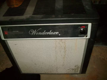

And judging from the photo's I see liquid creosote on the ground, also if you look on the power cord to the unit you can see some drippings on that

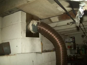

The flex comes out the side of the chimney creating its own 90 deg and then down to the stove creating another 90 deg. It is one pipe from the rain cap to the chimney.
OK that is not how it is supposed to be done at all you should have a tee inside the chimney with the snout coming out the crock. Then switch to stove pipe which you can easily disassemble to clean
