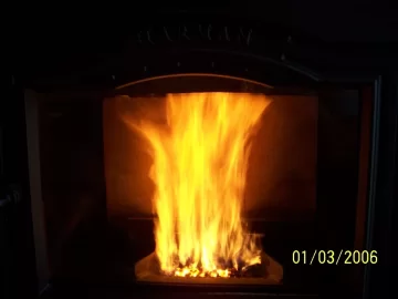

Also I did notice when I lifted hopper the flame increased.I really never noticed this before, Is this normal?

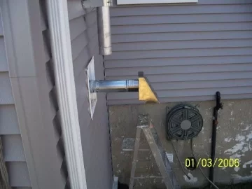

I am going to disconnect all the vertical pipe and run it straight out adding a 1 foot section and a termination vent to it and see how it goes. I'll report back how I make out.

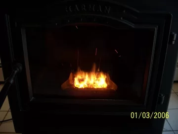

Well it appears to be running much better.Time will tell if this was really the issue. No smoke at a low flame yet The picture looks kinda orange but in reality it is a nice light orange blue. If this keeps running well the only thing left to decide is wether to add outside air as this is the minimum configuration recomended by Harmon.

Shortening up the pipe seems to have cured the problems I was having all around in terms of the lazy sooty flame and the smoke in the box. I really want to thank all who helped me sort this out. I'd still be chasing my tail if it weren't for your help.

Question - in the pic showing the vent pipe setup, was it required to extend it that far up vertically? or could it have stopped once it came out of the house using what looks like a dryer vent type setup?
Thanks
I could have gone strait out with the piping (like a dryer vent). I chose to go out and 90 degrees up approx 4 feet to obtain a better draft. Thoughts?
