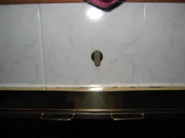

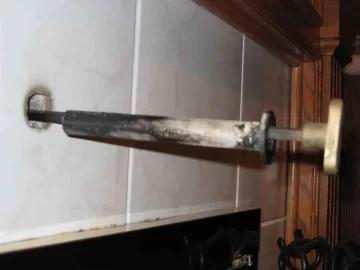

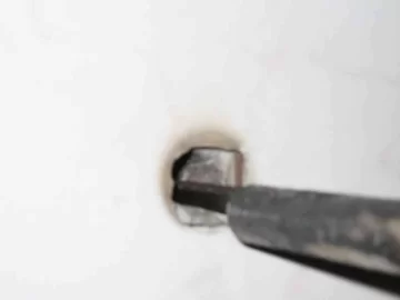

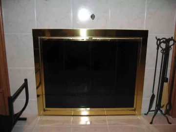

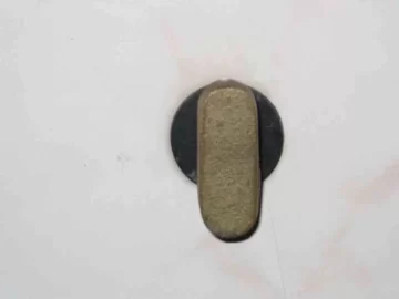

Had a fire in my fireplace a couple of weeks ago and noticed a smokey smell in the house. It seemed to get worse as the fire burned longer. I decided to take a closer look to see if any smoke was coming out. I didn't notice any smoke coming from the fireplace opening, however I did see a few little wisps coming from the opening where my rotary damper control comes through the front of the fireplace (just above the main fireplace opening). If you look at the pictures you can actually see a small amount of smoke/soot stained on the tile. My question is this: Is there any way that I can seal off this opening through which the damper control protrudes so that no smoke can get through? I slid the pieces out (they were already loose, no cement/sealant) to get a better look (see the attached pictures), but I didn't actually look at anything inside the firebox. Let me know if additional pictures from there would be helpful. Thanks in advance!

So, I judge from your response that these types of damper controls (that come through the front of the fireplace) don't need to be sealed. It just seems like a potential problem to me that there is a hole through the front of the fireplace that runs into the flue/firebox. Don't most fireplaces have a damper which operates with a handle inside the firebox?

So, you guys don't think that the fact that this damper control opening is not sealed is a problem? If that's the case, I'll work more on the draft situation next time we have a fire. I'll pay more attention to what appliances, fans, etc. are also running.
