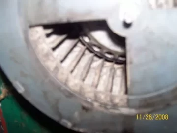

I had a fan that got noisy it was off balance cause there was a bunch of crud built up on the impellar I shut the EKO off (due to its flushing, unpredictable fan on and off cycles)removed the adjustable shiled on the EKO's fan inlet, and used a screw driver and scraped the junk out of it,when the fan turned on the next time it threw some junk behind the cover but that was easily cleaned up..Dave
