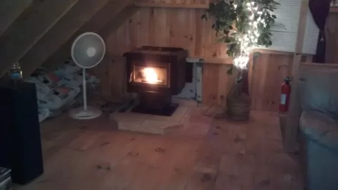

Hello all new member here.
I bought and installed an older pellet stove a few weeks ago in my loft. It's an earth stove mp40. It's directly vented out through my wall. I have been running this stove nightly and it's been flawless! Well i woke up at 2am and my loft was full of smoke so i shut her down! Going to clean her out again but wondering if anyone knows what might cause this Smokey problem? This is my only heat source in a in a loft that is not insulated (working on it) in New England so i need to address pronto! Thanks in advance.

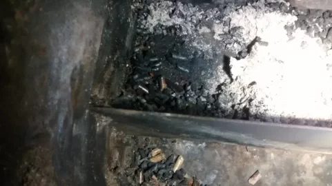

Took out the burn pot. As i was vacuuming i noticed a good amount of half burned pellets in the ash bin. Is this normal and if not could this be what caused all of the smoke?

Smoldering pellets...what kind of pellets? The ash bin should have just ash and Mcnally whole or not fully burned pellets. I encountered some pellets that did this 1 they never burned right.
