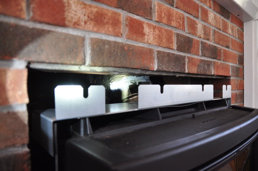

    I pulled the surround off and took some photos. I'm working on uploading them now. Photobucket acting up.

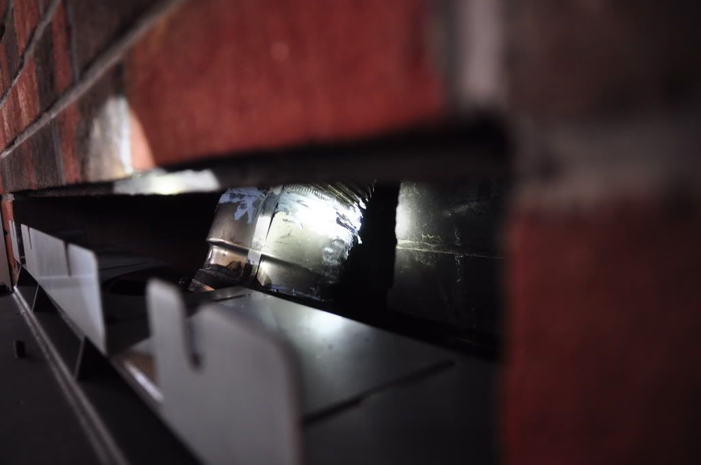

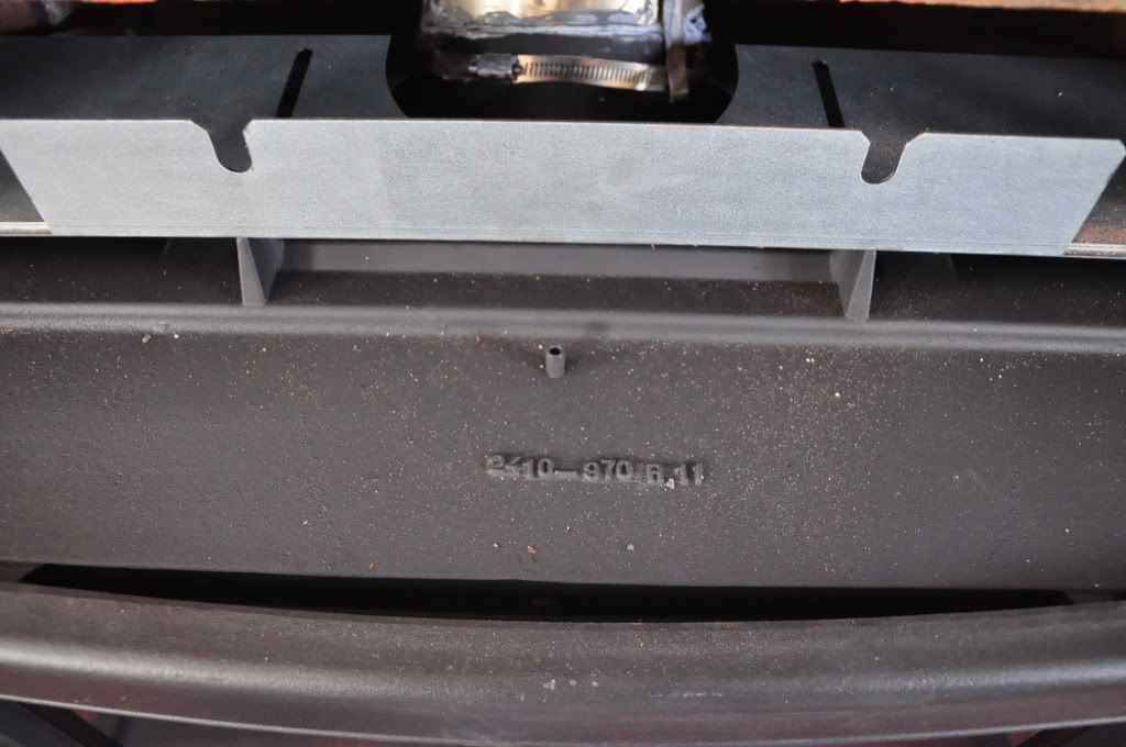

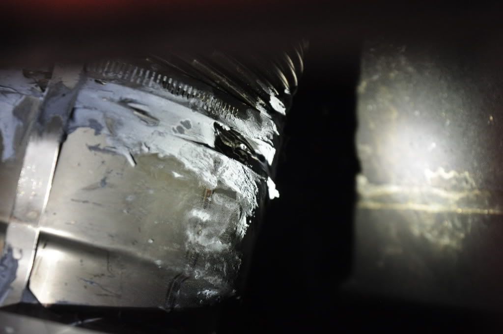

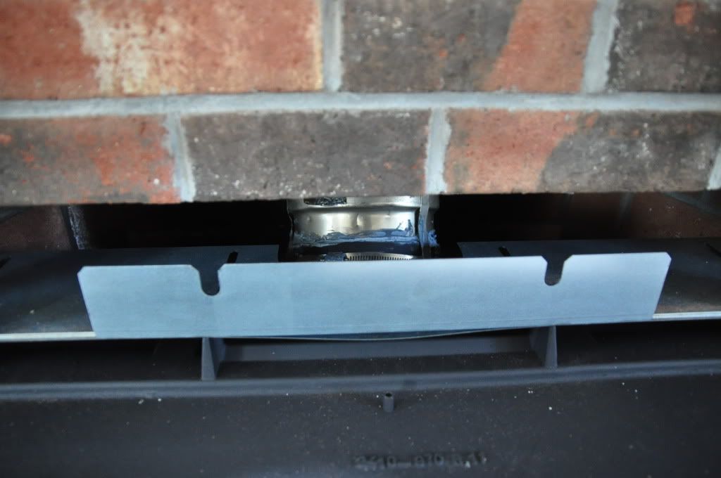

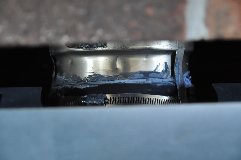

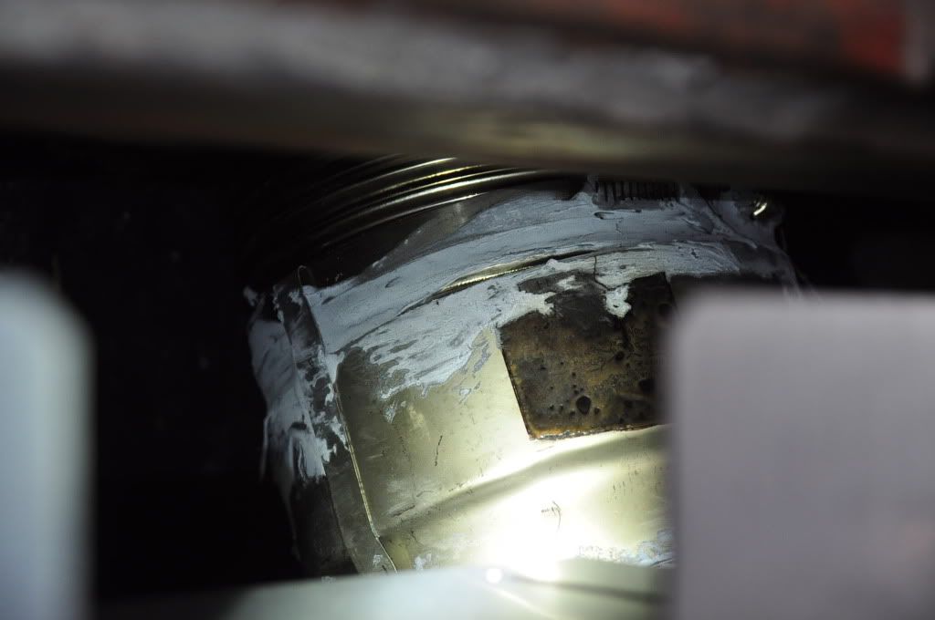

    Here are the photos. The last two show a gap in the sealant used. Not sure if there is ANY sealant in there or not, can't tell without looking from above.

  11. HotCoals

    With the surround off do you see any smoke back there?
  12. loudog
    loudog
    Member 2.
    Oct 8, 2012
    104
    11
    Massachusetts
    Not right now, but the fire is currently reduced to embers. There is no smoke coming in the house at this point. Wondering if we should take one for the team and light another fire to check it out. Smoking ourselves out on Thanksgiving!

    I think that's the only way to rule out the connection issue.
    The fifth pic down looks like there are two pipes?
    Maybe just a optical illusion?

    That sealant doesn't look like furnace cement. Is the smoke smell somewhat chemical in nature? Ask the installer exactly what compound they used there. I'm wondering if that is silicone? If so, it doesn't belong on a flue collar, even if it is "high-temp" silicone.
    Second question: How many hot fires have you had in this insert? Have you had the insert up to 550-600F for a few hours yet? If not, and the smoke may be the paint baking in.

    Hmmm, not furnace cement. I don't like that at all.

    Stay calm. The installer may have used mil-pac as the flue sealant. That's why I said to ask them. Usually it takes 2-3 hot fires to bake in the stove paints and burn off oils etc.. Keep a window open a bit and let the stove get up to 600F for an extended period. If the smells go away by tomorrow or the next day then I wouldn't worry about it. If not, call the installer and demonstrate the problem for them.

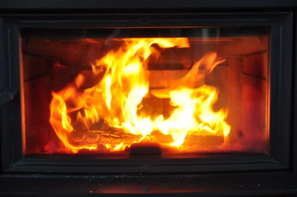

    So, we threw some pine in as recommended and got a nice little fire.
    [​IMG]
    No visible smoke from any of the liner joints. However, the house did smell like smoke during that fire.

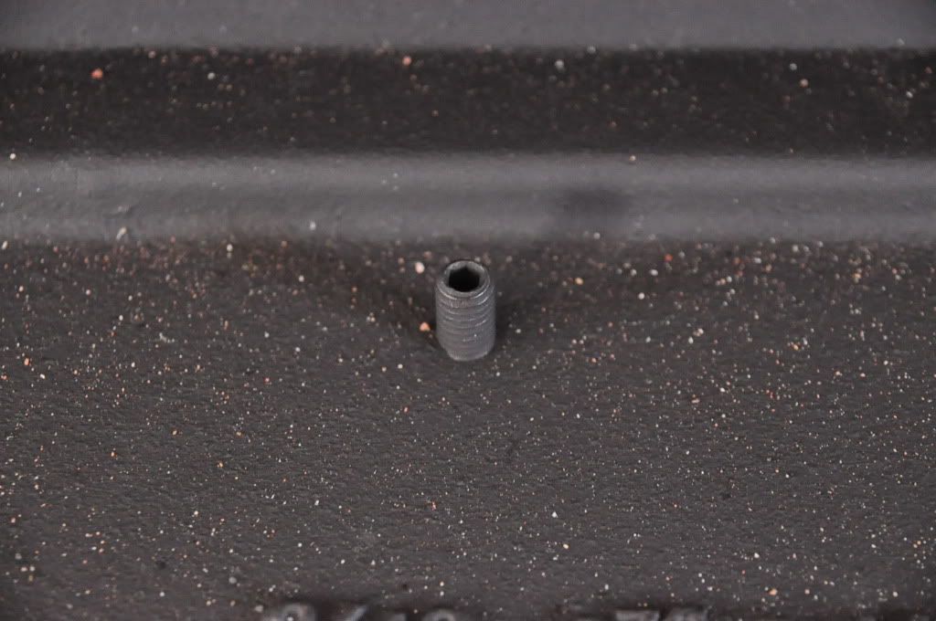

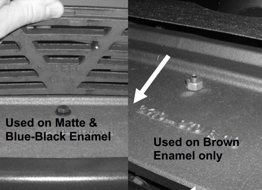

    Also, I noticed the draft sample port in the manual. We have the matte version of the stove, but apparently have the enamled version plug. But, there is no lock nut on ours as pictured in the manual.
    Manual:
    [​IMG]
    Ours:
    [​IMG]
    [​IMG]
    Should this thing be screwed all the way in? It's loose right now.

    I dunno..but you would think it should be tight.
    She is sure it's not just the paint curing?
    Maybe the ash was just laying on the stove waiting to be blown off?
    BTW..a pic farther up shows what looks to be the same plug but has a nut on it also?
