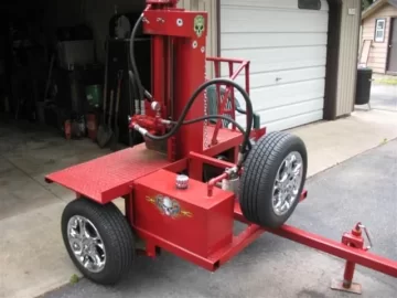

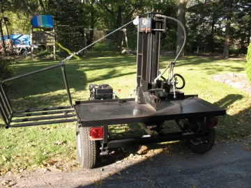

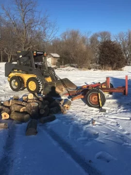

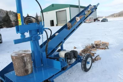

My cousin called me the other day and said he needs his splitter back. And I have maybe a cord split. And now it's time to have my own. I'm not super enthused with what's avaliable at the store. I'm going to get some pricing on the power split, I have drawn up some plans to build my own clone of a power split. I was curious if any of you have used one or own one? I want a log lift , work table, fast cycle time. And potentialy a conveyer but that's not a nesesity. I don't use a ton of wood, maybe 5ish cords a year. But I like my equipment to work hard time is everything. I was also thinking I would run the hydros off my skidsteer, rather than buy a motor and pump ect. My cousins splitter has worked great for me. Here's a pic of what I have and what I want to build. Or buy. Depending on $ [Hearth.com] So I need a splitter...[Hearth.com] So I need a splitter...

Yes. I am most likely going to build it and make sure it's the right height for me doing the bend and twist got old the 2nd time I picked up a log
Better off to self power it, doesn't tie up the ss and does not run the hours up on it either. Then you have to look at the flow rates of your ss as well. Unless you have a high flow function on the ss a lot are only around 7/8 gpm straight output. A two stage pump in the 11/13/20 gpm areas will actually be faster because it only kicks down to low output high pressure when needed, the rest of time ( like around 80% or more it is running at low pressure ( maybe up to 900psi, high output.) hi pressure is around 2500 psi at apx 1/3 the high output gpm. depending on the pump specs of course. Cycle Speed is dependent on how fast you can fill and empty the cylinder, if you ditch the 1/2 id lines and go with 3/4 " and have the cylinder with 3/4" as well ( that's the hard part) it will be quite speedy even with a 11gpm pump. Store bought units are all about least cost for max profit- not max efficiency. Note I picked on 3/4" because that is a common splitter valve port size. There is an auto return valve available as well ( little pricy at $349)

To be comparable to the output of your skidder you will need an 11+ hp engine and a 22 GPM two stage pump. Just taking a swag, but that will be a small percentage of the cost to build the blue machine in your pic above. Take a real good look at the irons used for that splitter. I am betting you will have a pile of dead presidents for those irons (and the one below that you can't see). The hydro motor and elevator portion won't be cheap to hand build either. The proportioning controller and valve to the hydro motor must also be taken into consideration unless it is gonna run constant, but that brings different issues if using one common pump (like splitting the volume of the pump to a motor AND cylinder, hence the proportioning valve, or flow control).
I was planning to use a old conveyer I have and a hyd motor I have. I have Ton of stuff laying around. Also have hose and fittings and a hose maker. I do not have the valves and need some guidance that way. I re read my eaton hydraulics book but it's been years since I've messed with the valves and things. I was thinking to use virgin steel for the ram and table. I'm not afraid to spend money, just don't want to spend it all. You know.
So I finally got some time today to call and get some pricing. And wow. Just the little dingo table splitter that's towable is 7500 ducks. And the single conveyer self propelled jazzer starts at 18. I would be divorced if I spent even half that. Guess the build is on! (Once sugarbeet harvest is over )

[Hearth.com] So I need a splitter... [Hearth.com] So I need a splitter... Building a version of the Powersplit cost about the same as building a conventional splitter. The activation of the log lift can cost from $25,for a simple cable operated lift, to $150 for a hydraulically operated lift.
The advantage of the Powersplit design is the ergonomics ,all operations are on the same side of the machine and within easy reach. The wood stays on the table from start to finish. I have built 5 since retiring and have been asked to build more but my mind says you can do it the body says it ain't happening.
