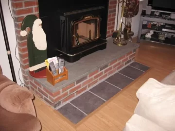

You can try something like this.The guys where i bought the stove put it in and i put the extra row of tiles in front to meet 18" code.You will get lots of help around here!

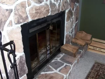

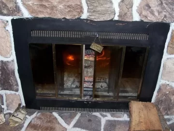

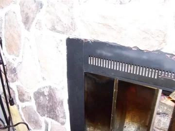

here are some pics. The one with the corner of the fireplace is where I THINK I should crack this walnut open if/when I do, but I'm not sure. Is there any realistic way to remove an insert without demolishing the stone around it. It's just veneer by the way.

It looks like a pretty good sized fireplace, so you could fit a good sized insert right in there without tearing anything out and hide the rest with the insert surround plate. If you find a local dealer or chimney sweep see if they can come over and inspect it and see what will work.
Can you get to your pipe connection.You would think that the surround plate would come off to get to tha fan motor if not remove the grout line around the fire place disconnect your pipe and pull it out then you'll see your bricks and the true size of your fire place.
most new insert thatt I've looked at comes with a new surround plate and most likely will hide the missing grout

What you have is NOT an "insert" it is a built in ZC fireplace. You do not need to "replace" it. You can simply slide an insert INTO in, that's why they are called inserts. I saw mention of removing all the guts, DON'T, unless you want to replace the entire thing. All inserts I have seen will only allow installation into a fully in tact ZC firebox. Once you start cutting metal out, you are done. Your other option besides an insert would be to rip the entire thing out, chimney and all, and replace it with an entirely new fireplace and chimney system.
The actual insert you linked to earlier (2700i) would be a good fit probably, and would go inside the existing firebox. If you want to replace the whole thing you would be looking at something like this:

To follow up with jtp, you're options are limited with inserts that are approved for zero clearance boxes. Use the opening of your doors to base the size of your stove on since the rest will need to stay intact. Plus leave enough wiggle room for your hands to connect the liner.

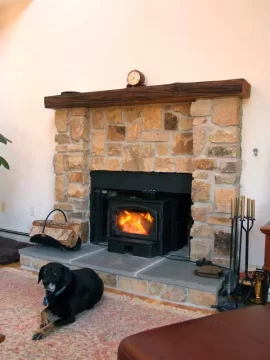

The Lopi Revere is ZC approved also and has a 10" cooktop, so it's not completely flush with the wall.

hhmmm....well I do like the sounds of your idea. Not having top tear anything out would be the ideal here. So would my course of action be to get an actual insert and I would assume a chimney liner and install that? Looking at my pictures aboce, what would come out and what would stay in relation to the current fireplace currently in place? I hope I can remove the current fan as it is frigin LOUD. Thank you for your reply and I will be pming you.

opps you just answered one of my questions. So is the liner attached from the outside of the insert liner connection and then the whole thing is then put inplace? I liked the picture of the one you had in your post. That would be great.
