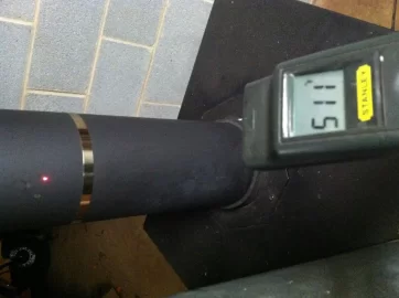

I DO NOT like high temps especially being a greenhorn but this was the last stage on my burn levels. Reached the big five 00 just now. The flue started popping around 475 but I held in reluctantly. All is well I think. I still wished I knew what a target temp as well as a max temp for a flue like mine would be. 6 inch 24 gauge pipe, clay lined chimney. House is 30 years old chimney is 3 weeks out of virgin status.

I dont own an IR gun and I cant measure stack temps (insert owner) but I have to believe you have another 200-300 degrees before my butthole would be puckering. That is assuming your clay is SS lined. What are your Stove top temps when the stack is at 500?
No SS liner. Chimney never used so it would be throwing away money. I could see if it had been used for 30 years but it has not.
It's not a free standing stove so not sure what the temps are on the top. It's a furnace style stove.

I don't see it as a new or old chimney thing but the fact you are dumping a 6"pipe into a 8x12 or 1316 chimney designed for an open fireplace. What you are describing is a slammer install. You'll find lots of information on the site regarding those types of installs. Had one myself. Once I put a liner in I saw a world of difference in the operation of my insert. Keep a close check on your creosote buildup
Well clay liners will take very high temps before damaged so you are fine with the 511, the safe range on most flue gauges is aroung 250 to 450 or so, but going above that for a short period of time is no problem.

Not sure where you got my flue sizes, Im not using an open fireplace flue. I have 3 pipes, 2 for the open fireplace upstairs and one running into the basement for my wood stove. all three are lined with clay. Ive used the 2 fireplace flues but the stove has only been used for about 3 weeks.

As far as the flue, as Jags said...if it works for you and you are comfortable with the safety level then burn on. As for temps, what is your stove top temp when flue temp was up there?
well, the top rarely gets over 100-130 BUT its a furnace stove not free standing so it has the cover over the actual stove.I swear, my dad has a clay flue and a similiar type furnace ducted into his existing vents and he revs his to the moon! Id say 800 easy. I just cant do that.
What they are saying is that without a 6" Stainless steel liner, your 6" pipe was "slammed" into a square opening....thus allowing air gaps and affecting draft negatively. It's not a waste of money. In fact, not using one is probably wasting wood. If I can guess from your picture, your stove is installed in the one (smallest one) on the left and is already showing signs of creosote buildup. Search the forums for "slammer" and read up. I'd also start looking for a chimney brush. Looks like you are gonna need it sooner rather than later.
BTW, hotter is cleaner (within reason) and yours looks dirty. Go take a pic of dads and compare the 2. Just sayin'
You should be within range on that pipe. However, the "burn it hot once a month" thing can be dangerous. It can help keep your pipe clean by burning up whatever is in there. If you have enough build up in there, setting it ablaze is not a good idea. I recall you are burning wet wood so you should really be inspecting your pipe to see how much buildup you're getting rather than blindly torching whatever might be in there.
If you have good draft and your clay is sound, I agree a liner is not a top priorty. Your flue is not that large (looks like 7X7). Keep working on getting ahead on that wood. ;)
