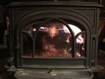

I live in a really old colonial cape style house. I opted for a cast iron stove. Go larger than you think you need. It’s completely replaced our forced hot air furnace and is a lot cheaper to operate. We burn 24/7. It’s done a really good job heating most of our house. Because of our tall ceiling in the stove room, we have about 10’ of stove pipe that’s helping out as well with a ceiling fan high up in that room.
It doesn’t take too long to heat up but yes it really only has three temp settings. Cold, hot and raging inferno lol!
