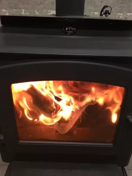

Here’s my Englander right now doing what it was bought for. It’s 29 outside, shop at 56, and I have to paint a stack of 12’ baseboards in here today. Latex paint.
yes, the meter is passing 725 as we speak. This is not ideal for a Bk but the Englander is happy to run hot.
