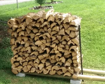

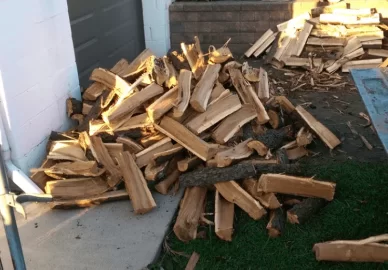

I was amazed at how fast softer woods season. I have had white ash stacked since April of this year and it is still registering around 26% moisture (I split it big)
I cut a Norway Spruce down in July and stacked it at the end of that month. Now measuring 14% on a fresh split.
The thing that amazed me the most:
Black Cherry C/S/S on August 18th of this year, stacked single row in sun and wind is now measuring 21% on a fresh split. I'm amazed at how fast that cherry seasoned. I would have never even thought that wood would be anywhere near burnable unless I checked it with a moisture meter - love that thing.
