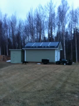

I had installed the panels on the roof in August, but between work, cutting firewood, building a coop for my ducks, etc and then it turning colder than heck I didn't have a chance to finish the wiring.
Warmed up over Christmas and I had a few days off from work so I knocked it out.
I don't have any photos of the install in progress. I had them on my phone and somehow they all got erased !!!

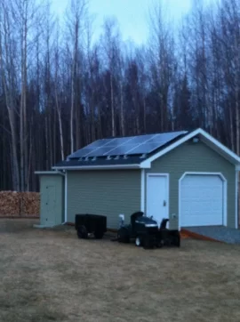

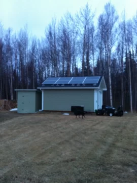

I put up 16 panels in total, 8 on each side of the roof, 3840 watts total.
Everyone says north facing panels won't work that great BUT it was either only do 8 facing south or 16 facing south and north.
I'm going to run it this summer and see how bad the difference between the south and north facing panels. Hoping that with the way the sun is overhead in the summer that it will be ok. The online calculator is saying about 1805 kwhr for the south and 952 for the north.
I might end up pulling them and putting them on the house roof... maybe add a few more then as well, I'd need probably another 8 to cover my electrical use.

Looks like you did the right thing using enphase microinverters. Your installation is definitely a special case and unfortunately the main stream solar media is oriented to far lower latitudes. Even at my paltry latitude, I miss out on production in the summer as my panels are not oriented north of the east west line for part of the day. I do expect that you will have a very seasonal system with the vast majority of production occurring in the summer as I expect snow cover is going to be an issue. If you have the site, a tracking pole mount array would be the best set up as it would optimize your winter angle and make a major difference in spring and fall.
I don't really have to worry about snow as it generally blows away. The pics of the building in my first thread were taken this afternoon.
The angle of the sun during winter is very low and we only have a few hours of light. For max effectiveness I'd need to put the panels at around 85* for the winter.
Nice setup Nate - I like the idea of panels on an outbuilding. I want to add solar, but living in an antique I don't want them on the roof of the main house. I'd love to mount an array on my garage, but it gets too much shading to qualify for financing the install, so its a non starter here.
With me doing it all myself the cost wasn't too bad. To just write a check and have it done it would have cost me around $20k. I was able to DIY for about 1/3 that.
I like your savy DIY attitude - but you are leaving alot of potential on the table. I have 20 panels, all oriented south - and I get 4+ kw for 5+ hours a day in the winter... Find a way to get all of them pointed south. If you can make the array adjustable so it's get close to perpendicular to the sun it willl really add up. I adjust mine spring and fall. Summertime I'll get 4+ kw for 8+ hours.
To get the most - solar panels need to see the sun - not diffuse sky illumination.
Nothing I already don't know, but like I explained I had a specific roof space to work with so I made use of what I have.
The sunshine is much different in North Carolina than it is here so you can't exactly compare outputs of setups 4500+ miles apart. ;)
I get enough daylight to power on my inverters from around 1030 to 1530. Looking at other Enphase installs in North Carolina, looks like they are seeing inverters on from around 0715 to 1730. That alone is a 5hr difference. That doesn't even factor that with the sun sitting low here it's usually kinda overcast/grey and not very powerful.
It will be another 2-3 months till the sun starts coming more overhead.
If I compare to other setups around this end of the world, I'm making normal power #s.

Have you the space and exposure to do part of the array as a ground mount that can face south? Maybe it could be on the roof of a new woodshed?
Where I have space in the yard it would look weird. Also I'd be worried about animals such as moose . If I do end up moving them it would be to my house roof.

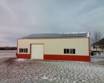

I have 40 panels installed on the south facing roof on my shed. During the dead of winter, I will only generate on average 20kw per day. During the height of summer they will produce on average 45kw per day. The panels are mounted flush on the roof at a 18 degree pitch. Day light hours here will double from winter to summer. Late fall is usually more overcast, so less production. I have SolarEdge optimizers to help with the snow cover during the winter.
http://imageshack.us/photo/my-images/688/0103121434b.jpg/
The number of daylight hours per day makes a significant difference as well as the amount of cloud cover. I think the further north a person, the less they have to be concerned with the amount of production during the winter months. Concentrate on the months that the sun is shining longer. You will make up most of what may have been lost during the less productive months.

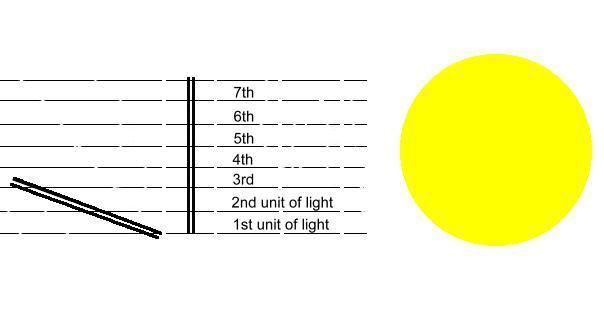

Would it be possible to build two racks each holding 4 panels? Each rack could be mounted on the south wall using a hinge on the top edge of each rack. Then you swing the bottom out from the wall so your panels are approximately perpendicular to the sun. With the racks being movable I don't know what problems that could cause with wiring though. Your sun angle might be low enough during the summer so that the top rack wouldn't shade the lower rack. At my latitude the lower rack would be shaded in the summer.
At that latitude mounting on the south wall would get a lot more power. I aggree with Redskin. I doubt your north facing panels will ever get substantial sun.

The #s from PV Watts is showing about 60% output on the north panels vs the south. So far the north panels have made ~1400wh while the south have made 2500wh.
I could mount maybe 3 panels to the wall but that's really all that would fit. The panels are 38"x65". The wall is only 8ft tall, 20ft long.
Will see how it works out this summer and if it comes to it the north panels will end up on the house roof.
1400wh while the south have made 2500wh.​
How can I say this nicely? They are both horrible! 50 cents? I would build a stand mounted on the ground so the panels face the southern horizon at 61 degrees from horizontal (29 degrees from vertical) or whatever your latitude is.
About 0.65$. Latitude is 61.59*
I think you forget that it's winter in Alaska. We don't exactly have much daylight. If I make 10 kwh this month I'd be surprised.
