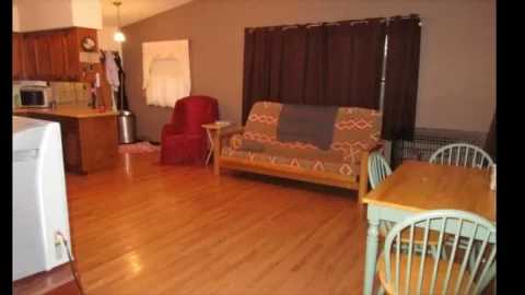

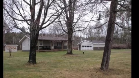

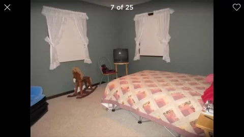

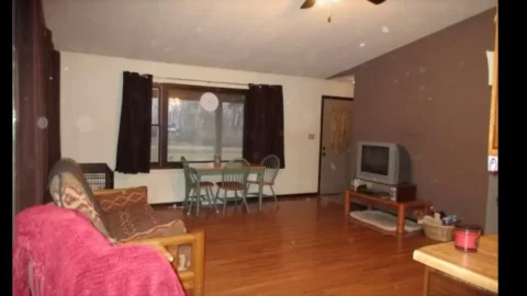

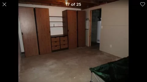

Here’s the place, I paid $98K for it and the seller is spending $4k to replace the old steel tank on the conventional septic system. The yard has 1.77 acres and is square and it will fit a 36x56 metal shed behind the side of the garage I’m thinking. It has 900 sq ft on the main level and the same in the basement. The basement is dry with it’s poured foundation- I wouldn’t buy a house with a wet basement. We recently has 8" of rain in a few days and I checked the basement then and it was bone dry. Anyways, it has 4" walls and I assume R13 insulation in them. I don’t know what the attic looks like for insulation yet but if it inadequate I’ll blow more in it to bring it up to what I should have. At this house here I never heated the basement but it has A ICF poured foundation and the walk-out Wall is R-21 insulated and it only got down to 48 or so in the coldest months. I plan on doing the same at the new place. I’ll mainly heat it with the free cord wood that is easy to find up here as there is lots of hardwood forests here. I want to get a Drolet Escape 1800- the pedestal model that sells for around $700 when they go on sale at Menards. Whatcha think?
PS- those very dated drapes will have to go and I’ll be putting T&G wood on the ceilings and some walls at some point in the future to make it look more like a northern place. [Hearth.com] Sold the house- need to start over with a new stove[Hearth.com] Sold the house- need to start over with a new stove[Hearth.com] Sold the house- need to start over with a new stove[Hearth.com] Sold the house- need to start over with a new stove[Hearth.com] Sold the house- need to start over with a new stove

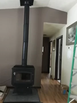

Well I finished putting in the chimney for the new stove yesterday while it was warm out and it’s 29 out now and snowing some so I’m letting the house cool down some so I can try a first fire in the stove. I have 6’ Of double wall stove pipe and 6’ of chimney pipe in the stack going straight up and out- hopefully it’ll produce a good draft....? Time will tell. And I still need to add a electric outlet behind the stove for the fan as can be seen in the photo with the cord stretched over to the left.

Looks like a little curve in that stove pipe. Will work just fine though.
I’ve got just 12’ and have been happy.
I noticed the curve too looking at the photo but for some reason it’s more pronounced in the photo than in person looking at it but I’ll have to see if I can tweak the pipe a bit yet to straighten it up some. I had the first fire in the stove a few hours ago and it drafted well.
