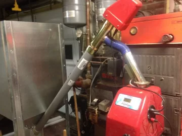

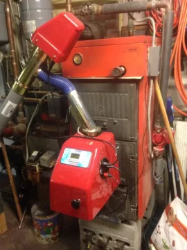

I have a Techton Sime solid fuel boiler I purchased new 20+ years ago. Burning logs has gotten to be to labor intensive and time consuming. I discovered last month the Pellet Burner. Did a little research and purchased a ULMA 2000TC pellet Burner from Tim at "Pellet Pro". I live in the lower Hudson valley of New York and the transaction occurred online. I ordered the older version with the manual burner cleaning feature. I also bought the auger and medium storage bin. Everything arrived on Friday and the unit was up and running Sunday nite. I had to modify the boiler door to accept the larger diameter burner tube (was constructed with the option of installing an oil burner). Installed everything myself with telephone support from Tim. Today is day 2 with the unit performing well. I still need to fine tune the controls as I use my oil boiler (piped in parallel) as a backup.

Well Im the OP and no I don't have any affiliation with the vendor or brand mentioned in my original post. Just thought the information would be useful for someone who may be in the position I was in when considering options for a pellet burner. Im somewhat surprised I didn't find any US manufacturers they all seem to be coming from Sweden (from the limited knowledge I have). I also didn't find many BB or forums discussing the topic of pellet burners. Anyway its day 4 and the burner has been functioning nicely. I still have to adjust the combustion or at least determine the efficiency sounds like something to do this weekend ( I have the time now that im not cutting & splitting wood).
