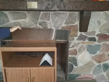

I went to Alro Steel and got two pieces of 22 ga. stainless steel - each 13" x 53" - now I need to make a shield. The picture below is a mock-up of where my wood stove will sit - with the microwave cart as a stand-in for the stove.
  • [Hearth.com] Solving 'Mantle too close'

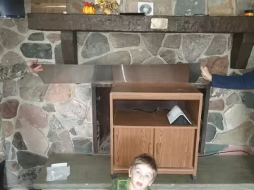

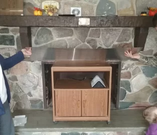

These pics are to show where I could put the shield, but I'm not sure how wide it needs to be? Or how far it needs to protrude from the wall? The mantle is only 7" deep.[Hearth.com] Solving 'Mantle too close' [Hearth.com] Solving 'Mantle too close' [Hearth.com] Solving 'Mantle too close'
Do I need something on the sides? Can I only go as wide as the opening to the chimney? Or will heat go "sideways" if you will, toward the mantle supports?
Counting on you guys to help me out.
Thanks!

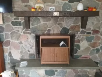

Okay, so it sounds as though i really need to be sure as little heat as possible is making its way vertical toward any of the mantle.
Looking at the pic below, how about if I put "legs" on that piece being held that go all way to the hearth stone (floor) the stove is sitting on. I'm thinking I could angle them out a bit so as not to "box in" the stove too much, but still direct the heat in a way that keeps it from going straight to the mantle from the stove.
AND, I will get an IR gun to keep an eye on things.
Good plan or no?
Thanks
