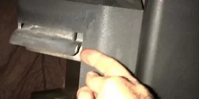

This is interesting. I took the old gasket out yesterday, noticing the worst spot where the old gasket was frayed lines up exactly with a sharp edge and a bit of a burr on part of the upper firebox (upper lip at the top of the box). Looks as if there is almost no clearance there for the gasket as the door is opened and closed. I suspect one time a couple threads from the gasket might have caught on that burr and lifted the gasket out a tiny bit. Then the burr and the sharp edge continued to do some damage over time.
I filed down the burr and the edge so even if the gasket touches there now it should glide right over that spot. New gasket will go in next weekend (I didn't install this weekend as I didn't want my wife and son dealing with silicone curing smell).

Thanks FyreBug - FWIW if this is the worst I have to deal with on the 2200 then I'm a happy camper. Just posting this here as it might be a worthwhile 5-second sanity check for any 1800 / 2200 owners reading this. I wonder - the way the gasket "flattens" toward the inside on the latch side after a couple years, if it just got to a point where it grazed the burr once and that did it.
Originally I suspected the butt ends as the problem, but as you might guess from the location of the frayed spot in my (crappy) pics the butt ends would have actually been somewhere on the hinge side- that part and the rest of the gasket was still in pretty decent shape. I think I could have run it for another season of weekend fires easily if not for the frayed part - but I was getting a bit of black on the latch side glass every fire, towards the end of the season last year, so I assumed a tiny air leak there.
I've seen the Osburn gasket kits in the stores that carry SBI products here, but nobody had the heavy 7/8" rope kit in stock. One shop was going to pull one off of a stove door for me, but I still needed to buy the high heat silicone. So I just went online.
Anyway, the burr was an easy fix (5 minutes with a file). And I got fast email support from SBI with answers as usual on the best replacement technique, etc. Just a bit of Murphy's law - the stove is a tank (but with a burr);lol
