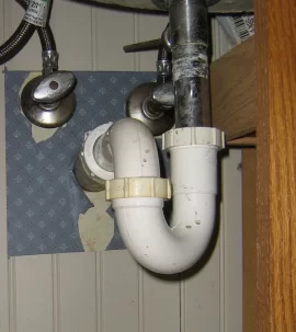

OK, buckle up as we take a quick swerve off-topic. Hope fully the mods will let it slide if we're brief. :) The S trap photo is current. The straight piece of PVC in the second pic came off the chrome(?) vertical pipe. It was pushed up several inches onto the chrome pipe. It had a big clear kind of washer in it that was making the seal. I took the gasket/washer out of it and put it over the chrome pipe. Then I dropped a 1-1/4" plastic washer into the PVC S. I was able to tap the S up as far as it needed to go. Then tightened the threaded cap on the chrome side, but for what reason, I can't tell.
I had stuck one of those 1-1/4" O-rings down in the S that mated with the PVC.
One of the tools in my toolbox is to stop leaks by fusing them shut using only profanity. Hope the description above makes sense. Thanks.

Looks to me like you had another tailpiece over the one off the drain.
