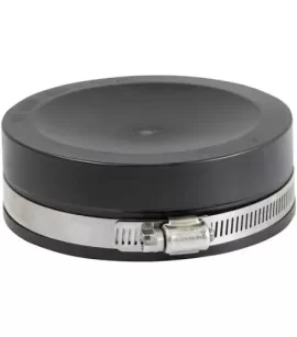

Get one of these and put it on the top of your chimney in the summer
I've been capping the top of my liner with something like that, so I don't get warm, humid air in the liner condensing inside the stove, which is cooler due to the AC.

Where can I get one of these ?
Chimney Cap World, right next to Toys R Us. ;)
Seriously, you can use a coffee can lid or the bottom off a gallon plastic jug or whatever, and tape it to the top of the liner to secure it..
What he's pictured there looks to me like some kind of plumbing thing, a vent cap or something? But that would cost money.. 😏

I'd pop a cheap metal cap on before ordering a rubber plumbing fitting, but hey, whatever works for ya
