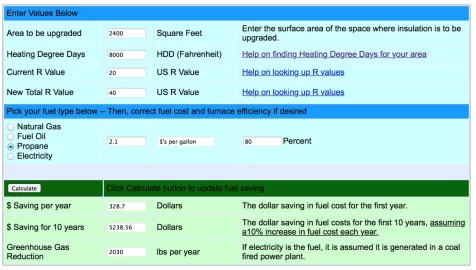

He should certainly do the calculation but also you gotta look at cost of insulating vs gain in savings/efficiency. Here's a good link for a rough calc: http://www.builditsolar.com/References/Calculators/InsulUpgrd/InsulUpgrade.htm
http://www.builditsolar.com/References/Calculators/InsulUpgrd/InsulUpgrade.htmAndrew
Yes, heat loss calcs are important here. As far as stove size, there are two schools of thought on this one. It's question of whether one wants a stove sized for the majority of heating days with an occasional boost from the primary heating system on coldest nights, or if one wants a stove sized for the extremes and is ok with a bit more fire management on the milder days. We faced the same question. Both the Spectrum or the Summit would heat our house well. What tipped the scales was Tom coming up with an offer for the T6 that I couldn't refuse, but based on my next door neighbor's experience with his Spectrum in a slightly smaller, but uninsulated house I have no doubt that the Spectrum would heat our 2000 sq ft old house well. Amazingly, according to Tom's tests, it has roughly the same burn times as the larger Summit.
Thanks for the link to the insulation calculator. That is helpful. Here is what I input for this situation. Does the results sound about right to you? $5238/yr is a very nice savings.
It is helpful. So is reading the chart properly ;) That savings was based on 10 years. So I figure to double the insulation should cost at least another $5000 compared to R20 (especially when paying someone else to install it), so you're not really saving anything in the long term.

Ah, but there are other gains, especially if AC is used in the summer. But also for a quieter house, increased home value, and the calculator is based on current energy costs. Do you think they'll be higher 10 yrs from now? I do.
