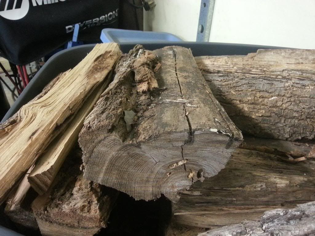

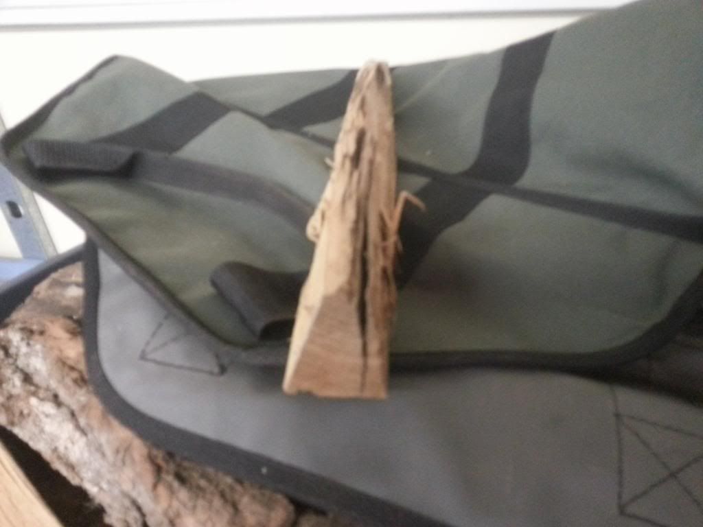

The house my wife and I live in today came with an old fireplace insert. The previous owner gave us some direction on the best way to start and maintain the fire which worked well with that insert. Only small splits were used, which created a great bed of coals quickly and burnt nicely, but needed to be loaded often. Here is the typical split size we use:

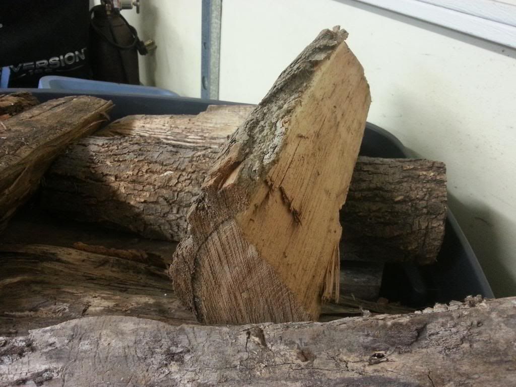

I see from the pics that you have some black locust in there. That stuff burns HOT. Have you considered using a different type of wood for the early and latter part of the heating season when it isn't so cold outside? I know you can't tell in my avatar but the front 3'-4' of the 2 rows on the left are cooler burning wood; silver maple, birch, poplar, etc. They are burned when the temps only get down into the 30's. Behind that is the hotter woods; oak, locust, hickory. I have that set up for burning when we have high's in the 30's in Dec. and Jan. Just a thought.

The guy who provided the wood said it was all hardwoods, mostly oak. I need to get smarter with this stuff to be able to tell what I am actually burning. I do know there is no pine, and everything has been seasoned 1-2 years now. Which picture shows the black locust, pic #2?
It looks like most of the wood in both pics is locust.
