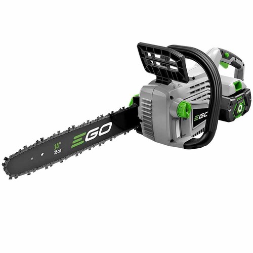

I like my Ryobi 16”. I also just go an ego battery chainsaw. It’s great for little jobs. Refurbished off eBay. It would be fine for cutting splits down in a jig.
