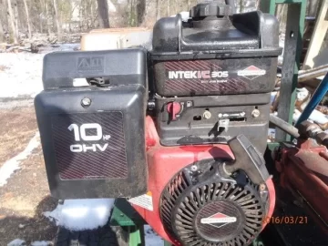

OK... I have blown up this engine. also see https://www.hearth.com/talk/threads/motor-for-a-splitter.154135/

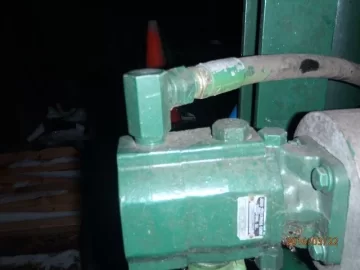

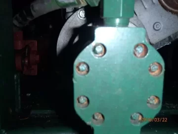

This I think is the pump
[Hearth.com] Splitter pump questions.
First question : can some one tell me about this pump?

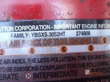

Second question : Do I need this big of an engine to operate this pump?
Third question : have I given enough info on the engine ?
Like shaft size and length, so I can find a replacement?
Thanks for your input!

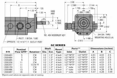

Bolt pattern for engine base.

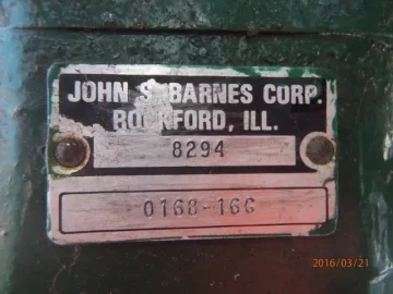

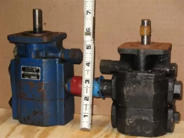

Unfortunately the numbers on these pumps vary greatly depending on who they were manufactured for. With a side view picture and a dimension from the font of the mounting flange to the back of the pump we can give a close guess on pump size. Either 11 or 16 gpm the 2 most common.

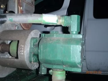

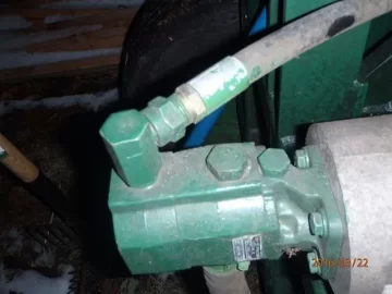

Here are some more picks of the pump.
[Hearth.com] Splitter pump questions. I will measure it later today.
Great
I will measure and get the dimensions posted today!
[Hearth.com] Splitter pump questions. [Hearth.com] Splitter pump questions.
A =
5 -15/16 "
B = 4.50 +/- "
C = 2 -14/32"
The one that reads 1.25 = 1- 8/32"
  • [Hearth.com] Splitter pump questions.
Although your dimensions do not match exactly your pump is most likely a 16 gpm 2-stage.

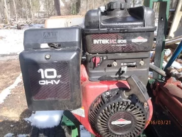

Do I need a 10hp engine to run the pump , or will a 8hp work?
I will confirm that an 8HP will pull a 16 gpm pump just fine running a 2750 PSI relief pressure.

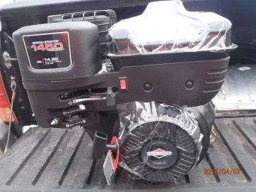

Going with a replacement 10hp $500 ;sick
I did replace this 10hp
with the new improved
How do we refer to this now, Hp was easier!
Easy replacement. I do believe it's stronger than the 10hp.
