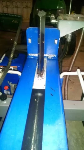

I have a 20-ton bi-directional Powerhorse splitter from Northerntool that has split everything I have thrown at it. Oak, maple, locust, gnarly elm, etc. It does have a fairly narrow wedge, and does as someone else mentioned, basically knifes thru the stuff.
