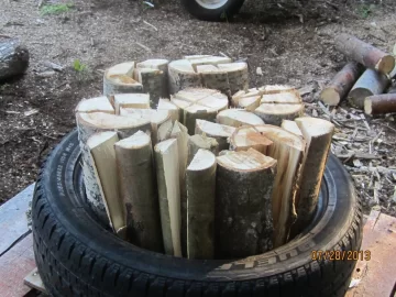

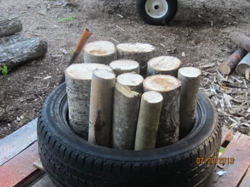

I use hard wood pallets screwed together then a piece of 1/2 inch of plywood screwed to the pallets and a tire screwed to that.

It works good for me. With the tire the blade never hits the pallet, the handle hits the tire first.
Splitting on the ground dulls the blade, in the tire the wood all stays together.

I like the tire idea. That is my next project. Bending over and sitting up again is most of the work.
How do you keep from breaking handle with pieces in middle?
It's the height that works best for YOU. I am 6'2 splitting 20 inch splits. So 18 works for me, of course in the tire. Large rds bigger than 20 dia get 1/4 on the ground then in the tire.

I whack the outside rounds first, the I aim for the ones on the inside. The handle usually finds the gaps.
I do this as well, I 1/4 the round to get it to fit in the 20" tire.
