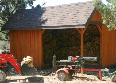

    I don't have to deal with monster rounds of hardwood (or any other rounds of hardwood :p ). I buy most of my wood, either in rounds or split. In either case, there's always a lot of re-splitting to do. I move rounds/splits to my hydraulic splitter in the bucket of my tractor, and just slap 'em over onto the rail (I typically split horizontally). My hand splitting consists mostly of re-splitting for my smaller shop stove, and splitting kindling. I like using a round as a splitting block, as shown in my avatar. That one's right outside my workshop, and there's another just like it in the open corner of my woodshed. Bark becomes my ground cover. If I was hand splitting big hardwood rounds, I'm sure my whole routine would be different. Rick
