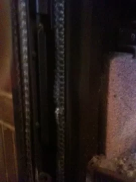

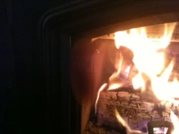

Hi All,
I've been working and practicing with our new QF Voyageur insert over the last week, and things are going pretty well! The fire is burning very cleanly, and it's putting out a lot of nice heat with the help of a slow revolving ceiling fan. Over the last week with daytime temps in the 30s and nighttime as low as 18, our furnace has come on only twice for about 5 minutes.
The glass on the insert is staying pretty clean now -- but there's one spot that always seems to come up within about 5 minutes of firing it up. The rest of the glass is clean. The spot is right by the hinges on the left side of the stove. This spot won't burn off. And when I look at the gasket I see there's a very small gap there. I've tried to take pictures of both the spot and the small gap (about 1/2 inch or so).
Does anyone think this could be causing the spot? Or is it just the hinges? Or should I just take a chill pill and not worry about it?
Any advice is welcome.
My thanks,
Mary

First, I would call the manufacturer and find out if this can be fixed or ajusted. If not, I wouldn't worry about it too much, my Lopi Revere does the same thing and has for the past six years. You will likely get a bit of crud by the door latch too.
There should not be a gap in the gasket. The reason you are getting black there is because the cool air is being let in there. You may need to replace the gasket completely but do not fret as it is not costly nor is it difficult. You manual should have the information you need as for gasket size. Gaskets can be purchased at most hardware stores.
You can always try to cut a small pc of rope gasket and fill the space missing in the gasket with it.
Cut the new pc of gasket slightly longer than the space you need to fill, then use high temp silicone or gasket cement to adhere it to the door where the gap is.
Thanks everybody! I'm going to try to put a piece in there and see how it goes. Fingers crossed! I'll report back. Thanks!
Mary
We'll be waiting for a report.
Good luck, Mary !! Go for it :)
