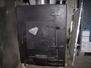

spotted this on ebay........another guy blowing smoke or the real deal?

any chance theres any validity to his claims?
I would agree with their statement:
A stove loaded with firebrick is a warning sign! Manufacturers use
firebrick to protect thin firebox walls. As a result the heat is
slowed from getting to the outside, causing heat loss up the
chimney. Firebrick will have to be replaced yearly and if a brick falls
out of place, a hole will be burned through the firebox, rendering the
stove unusable . Brick also reduces the size of the firebox. "
As per their statement:
"You can burn anything in these stoves and the warranty stands.....unlike some outdoor stoves that void the warranty if you burn anything but wood. "
I think your neighbors will balk and the EPA may frown upon this practice.
Back in the 70's when oil was steep and new manufacturers came on board they made all sorts of attractive slogans to make you buy their product. Some survived but very few... So you end up holding the bag because they are not around to support their warrenty.
Buyer beware!

I don't agree with the firebrick part, I am still a noob though. I thought the fire brick acted as an insulating feature helping to enable high temps which produces the secondary burn we all love. As far as everything going out of the chimney, my stove is hotter than my chimney most of the time when primary air is dampened down. I didn't replace all of my firebrick from last year, a couple of pieces had to be replaced, but that was because of my fault, not the manufacturers. Also I would think that the fire brick is instrumental in allowing closer clearances.
Looks like that thing is a monster and I wish him good sales.
We own a stove that is 30+ years old, a smoke dragon.. not a stick of firebrick in it.... runs like a champ and except for replacing the grate no complaints. Owned stoves, Z-cans and a Yukon Multi. I wonder why my all cast stove has lasted this long and I hear so many complaints from owners who have only had their stoves for 2-3 years.... if not 2-3 months?
If you didn't have firebrick in your stove you would not have had a problem to begin with?
Jim,
You're a bit mislead about the firebrick. Yes in some cases, some manufacturers were using it to protect overly thing metals. NOW we use firebrick because it helps keep firebox internal temperatures high enough to maintain a clean burn, helps to protect the steel AND slows some heat from entering the room.
And firebrick almost always lasts for more than 6 monthes - MY grandfather is burning a stove that has the same firebrick from the day he bought it 23 years ago.
Firebrick in itself means nothing. In fact, it is one of the best materials to take the real heat (and be replaceable). Even cast liners can warp and burn out, and it is usually more expensive than FB, plus you have to buy the part from the maker as opposed to "generic" FB.
Stoves like the Jotul 1's and 3's and Morso 1125 were all cast, yet lined with brick.
It is a great low-cost protector - and, as Corie mentioned, can be engineered to be part of an advanced combustion system.
"If you didn’t have firebrick in your stove you would not have had a problem to begin with?"
Hmmmm, I got no problems here. No firebrick cracked this year. Honestly I could have run the cracked firebrick I had still, but I didnt like looking at the crack. I ran it for awhile and it didnt get bigger or start to crumble. Nope just me being me and replacing it. No worrys here.
Being from Northeastern Iowa, I have actually seen one of these stoves.
I think it is the real deal. I am not sure about the fire brick part, but I know he uses some pretty thicked gauge steel to make these puppies.
Since when is a 3/16 firebox heavy duty?

I'll agree with you 100%... steel cannot take the temps over the long run and needs firebrick or some sort of refactory lining. Long ago most manufacturers got away from making cast iron stoves. We know the reasons why and in-order to put out a safe product they has to resort to some sort of lining.

As to this here thread, I would not spend $2,500.oo on that monstrosity, not to mention an additional 600 shipping, when for $1000 more
I could buy a duel fuel wood /oil hot water boiler, which is the direction I may take this summer.

Looks to me like a older englander3500...
I just measured the (seemingly) cavernous firebox on my furnace. 5.625 cubic feet, give or take a bit. Hard to measure with a fire in there, got it close though. So he's a'claimin' 10 cf? Wow, I could put my whole wood trailer in there. I can't imagine how much wood you'd burn with that crazy thing, although he does say you can burn anything and not void the warranty, unlike those tight-reared OWB manufacturers who will actually void the warranty if you burn anything other than wood!
He's taking a few right ideas, and mixing them with about 50 bad ones. Sure he means well and all, and somebody out there might swear they're the greatest ever, but I'd be pretty cheesed if my neighbor had one and decided to burn used tires, because the warranty says he can. Goes to show you, you can find it ALL on ebay, whether you want to or not.
That looks a lot like my 20 plus? yr. old non cat wood furnace. The size is the same too. Just my opinion, but the bigger the firebox, the more wood you'll use. I can get plenty of heat out of a small fire . But to load it up and get a really long burn you have to damp it way down until it almost smolders. One other thing to consider is no matter how big the firebox, unless you have a good blower to move the heat, you won't be happy with it. It took 2 yrs. of fooling around until I finally hit a good combo. I would find out the blower size before anything else.

{snip/}... One other thing to consider is no matter how big the firebox, unless you have a good blower to move the heat, you won't be happy with it. It took 2 yrs. of fooling around until I finally hit a good combo. I would find out the blower size before anything else.
Piston,
You have the right idea guy... no matter what, you need to move that hot air.. whether it is from a stove, insert, furnace or 'forum'! :P
The stove is definitely made for a plenum setup and most don't understand this point. Our little stoves and inserts are made to heat a limited area. I installed (back in the late 70's) a Yukon Multi forced hot air unit and it did work beautifully. The downfall was having to truck down the basement to load it and of course to get all that wood down there.
For those that have a large farm house or flat warehouse/shop facility.. this may be the Cat's-Meow.
