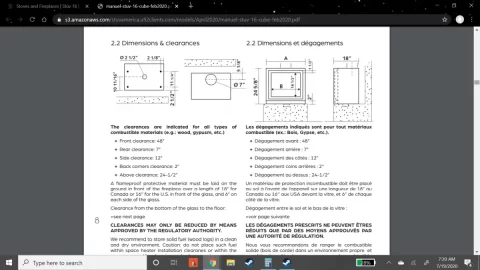

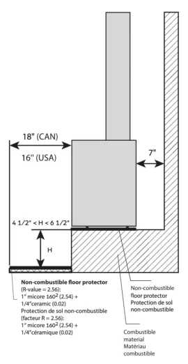

I think this is the diagram informing the platform recommendation - [Hearth.com] Stüv cube install - question regarding insulation under stove
quoting the installer - `One way would be to demo the existing hearth and install a new hearth stone that has mineral fiber board underneath it which is a product that is commonly used to alleviate thermal implications.`

If I'm reading the manual right, you shouldn't need anything beyond the hearth of your current fireplace. Begreen will know more than me about your hearth requirements based on the manual. What is your plan for the flue? Are you considering any other stoves? There are a few I would suggest instead of this one.
The original hearth is improper and the installer's suggestion doesn't make it more proper. If the house is sold and someone goes back to using the fireplace the hearth will not be code legal. That could end up being a liability issue.
A hearth pad that meets the mfg. spec is what is required. Might as well get or make one that extends under the stove from the back to at least 16" in front of the stove door. Or get a stove with easier hearth requirements.
Where is that specified? I likely looked right at it but didn't understand. I'd like to understand the specs.

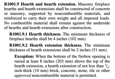

The hearth is supposed to be one continuous unit from the back of the fireplace to the front edge of the hearth with no combustibles underneath. This is our local code, which is essentially the national residential code plus some earthquake structural requirements:
Perhaps an attractive pad could be made that extends from the back of the inside of the fireplace out as far as needed for the appropriate protection.
