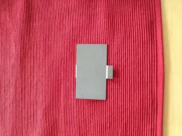

What he heck is this.. found it in the ash pan when I opened it..
Goes somewhere...

That is one of two or three ash trap covers. There is one on each side of the burn pot, under the decorative cover. Your flame must be rather lazy without this in place, since a lot of air will bypass the burn pot. You may have a third ash trap cover that will be mounted above and behind the ash pan. You will probably have to remove the ash pan to see where it goes. My stove doesn't have one, but I believe later ones had the third "door".
Heat seeker is correct. It covers 1 of 2 ash traps underneath and behind the burnpot on both sides. I tried taking a photo of where it goes but my stove is on and this is as good as I can get.
Its just underneath.
(broken image removed)
X2
Too bad I didn't see this earlier, would have posted a pic as I had the stove down and was cleaning behind those covers. It is as previous posters have said.
Yup. Sure is

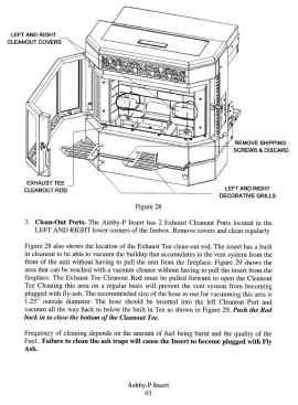

Yup, either side of the burn pot pn the Ashby-P insert as well. If you have two small ash pans one on either side of the stove, you will notice that the ash pans don't have a back. Those covers go on eitherside of the ash pans.
Your installation and owners manual should have them listed and show them in the exploded views.

If it's a Revolution, there is one behind the ashpan as well as the 2 below the burnpot, think the SCF-050 is the same ...........
Thanks guys!
The manual shows them, but not where they go..
Thankfully one fell into the pan, otherwise I wouldn't have known they were off...
