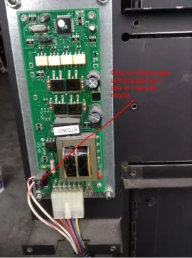

Well I did have a thermostat wire disconnected. However that has made no difference because I am in manual mode. Stove runs in start up mode and then cycles up to #3 setting and will not go farther. Unless 8 seconds off and 3.5 seconds on is high for the auger, but according to my chart that is just number 3 setting. I have attached some photos showing this. Click on them to expand them to see my comments. Am I just missing something here or what should be next step? Thanks!

I can't think of anything that would prevent it from going past #3. At this point, I would suspect the control board. I think that I see a jumper on the board. Is it in the correct place? Your manual will probably tell you what the jumper is for and where it should be.
ETA: make sure the jumper is making good contact - remove and replace it a few times to be sure.

Hello again......................the stove is not dropping down to an idle. If I cycle it down to setting 1 there is a noticeable change. When it is idling in thermostat mode the on/off light blinks. That light is not blinking. Where would this jumper wire be located? This is a link to the exact manual I have and it says nothing of a jumper wire. (broken link removed). Here is another link of St. Croix manual that does talk of a jumper wire, but this manual does not at all match mine and neither does the control it is showing. I have a 2006 Auburn stove. I really appreciate all the comments and helpful suggestions here and hope it is simply a jumper wire, but can't figure out why I never knew of that wire before............and it doesn't make sense with my on/off light staying on. Thank you so much.
In your 1st picture, where the 2 wires are under screw on bottom left corner, loosen screws, take 2 wires out, take a piece of where about 2 inches long, strip both ends, place 1 end under 1 screw and tighten, take other stripped end, place under other screw and tight, that is your jumper.
