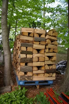

These aren't mine, they belong to HDRock, but you get the idea.
Reactions: HDRock
Damned elegant stack there. I'm still working on the artistic/architectural aspects of stacking and hope to reach that level soon.
Reactions: Nixon
That looks nice Pen, real nice...
I like to lean the ends in a little as I build it up. I think it adds a tad more stability. Keep practicing, it will click :)

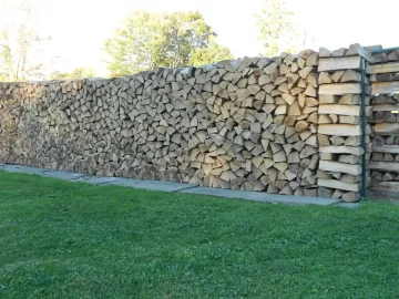

Nice stack. Is that flagstone under your wood?
Thanks. Yep, flagstone. Doesn't do the job as well as pallets will do, but they don't rot and I had access to a whole bunch for nothing.
The stacks above will spend one year there, then 1.5 to 2 years in the "woodshed" (under my elevated deck).
pen

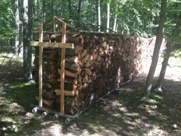

After trying several types of ends, I've decided that "pallet book-ends" are the most economical, secure end supports. Cribbing (cross-stacking) is more economical, but requires skill and is less stable and reliable. Tee posts are too costly (in $/cord stored) as are concrete blocks with landscape timbers and uprights. And there just aren't enough trees to stack against. Five 40" x 48" pallets (3 on the ground, 2 upright) will hold 1.25 cord.
They provide good ventilation and excellent end support. 1x4s can be used in the slots of the uprights to extend the height. I put the pallets on old bricks to get them up off the ground. They're cheap, easy to build and very reliable.
[Hearth.com] Stacking corners and sides......
I have tried different ways , And like the "pallet book-ends" the best, made from all free materials , I cut 16 to 17" long , stack 2 rows on the book end rack. It is 2 pallets 4'x6', so I have about 14" space between rows, I plan to keep covered to keep all the crap out of the space, sticks , leaves ,snow, nuts, dirt, amazing how much dirt falls out of the trees, oh yeah to me cross stacking, cribbing is a PITA, It takes way to long.
BUT ,there is always more than one way to do it :)

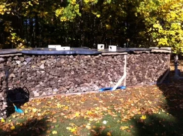

I tried the upright pallet approach for the first time this year and I'm thrilled with it. Makes life a lot easier. I tried cribbing the ends a few years ago and found it to be an enormous pain in the ass. It sure looks good, but it took me forever to find workable pairs of logs for the ends.
After that I moved to T-posts, which work fine but aren't very visually appealing [to my eye, anyway]. Some may think the pallets ugly, too, but I think they provide a nice, straight, clean look. This is my stack of next year's wood that I finished a few weeks back.
