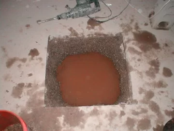

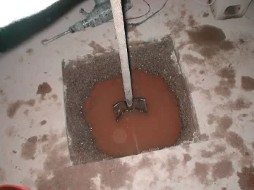

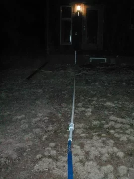

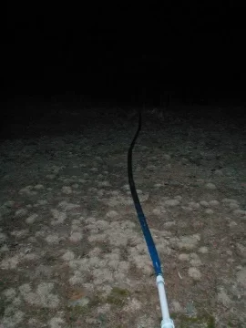

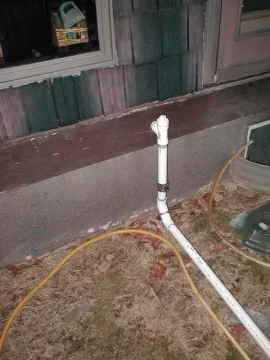

I spent ALL weekend cutting a hole in the conctret floor, removed the gravel, and dug the ROCKS & clay out for about 12 hours. Hauled out to the side hill 1 5gal bucket at a time. Between the huge Hilti hammer drill I used as a jack hammer and the lugging wet rock & clay to the hill. after 12 hrs I was spent, cramping everywhere, cold and cursing miserably LOL
I wanted to get the 30" sump liner all the way down, but I hit some kind of rock that would not break. Bedrock?
Stopped at about 20 inches or so. Which actually is plenty. After the floor was broke & lifted out the pieces, and the gravel underneath lifted out, wallah, water level 8" below the bottom of the concrete slab.

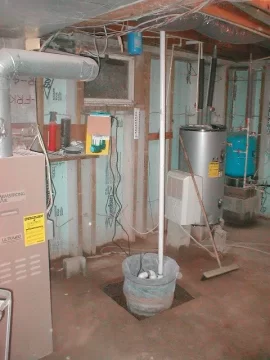

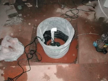

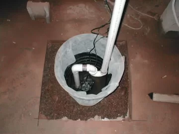

At this point I am cursing the previous owner/builder for knowing this land is WET, and not installing drain tile, which your right, IS a requirement for the Superior wall system. I found the paperwork stuck to one of the walls inside. Even have the "certified" installer's name and address. I now have the hole done, sump liner wrapped with sump cloth, and pump & piping to outside in place. Check valve with sepc'd 1/8" hole near pump in the PVC, and another 25' of vinyl heavy duty 1-1/3" hoes to the hill. This water is NOT coming back in anymore. I feel very confident that a drain trench along bottom of back & 1 side hill daylighted out will seriously help, at least for alot of ground water, and if deep enough, also subsurface water. I will also dig at the lower corner to below floor level, and just to the edge of the stone foot[ring for the walls (so not to disturb the footprint) and run drain tile pitched well to the side hill and daylight out there also. I am not going around the whole house as it is just not practical. And from seeing the water level, I should immediately relieve the pressure & problem by taking water from the lower corner out front and giving it a nice conduit away and out. I might go 10'-20' each way with the drain tile from that corner aong the house, yes away from the stone footprint. I am thinking go overboard a lil and do it once.
I may go from that corner 20' along the side and pipe to daylight, then 20 ' along the front and a separate drain tile next to the other alos to daylight. 2 pipes have to be better than 1 :).
and keep the sump inside for backup.
If this fails, which seeing the problem now I doubt it will, I will just go around the whole house, but only if necessary.
I have access to an excavator, now I have to teach myself how to use it out around the field and barn, nothing to screw up there ;)
Some photos of the project. This is one project that kicked my arse, and I had literally not an ounce of strength or energy left when 5AM rolled around from a 4:30 PM start. LOL

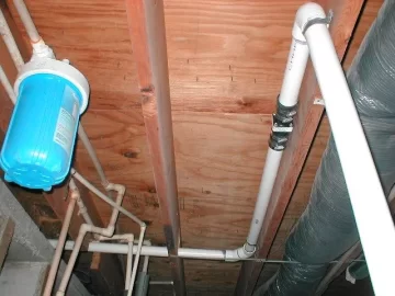

PVC, Check valve.

Outside piping & hose.
When I dig for the drain tile, I will also dig & install pvc to daylingt for the downspouts I can do this with.
