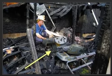

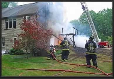

Wish there was a little more detailed in the report. The way I read it, the so called combustibles sound more than just leaves. Maybe trash was kept under there and who knows what other things.
One of my neighbors cut his grass with his lawn tractor. Then put it under his deck and threw a cover on it while the engine was still hot. Then took off to the store with noone else at home!
Well by the time the fire trucks arrived the whole side of this very new house was engulfed and it was a total loss!!!
So I do not think it is the deck, it is what you put under it!
See pics - As you can tell the deck was first to go!!! Also the firefighter found the tractor!
