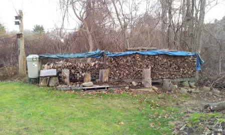

Starting season no. 5 and my wood still sizzles alittle

I usually only topcover the wood I plan on burning in a winter the summer before. All of my wood is seasoned at least three years minimum, two years without any covering at all. Do not cover the sides, you really need that air to travel through the stacks......and like Papadave and others have said, get as far ahead as you can. You never know when something comes up and you can't get wood for a season. I have around 25 cord on hand, plan on getting more when I get a woodshed built. My limit here at the house will probably be around 30 to 35, which will easily get me through 5 years.

:) Thanks backwoods! and others! Guess it gets alittle frustrating when i start fires and hear some of the wood sizzle.I think ill take off the tarps tomorrow and let the air do a better job.Looks like you burn alot of wood B Savage:)! how many cords do you burn a year? For us we burn around 3 cords! I usually start burning on a daily basis from late Nov till sometime in April.Last year was a extremely warm year so i didn't burn a great deal.

Uncovered the wood pile and What a mess! some of the wood physically wet and mushrooms growing out of some.Lets see how the drying works now.I'm on vacation next week!Time to cut up some wood from fallen trees in the woods.

Looks 100% better, Stanley. You'll see a big difference in that wood, given it some time to dry.

You now see why we suggest leaving the sides open, eh? Trapping moisture is a problem when trying to dry stuff.
